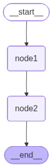

(上边有普通Edge代码示例,这里讲一下另一个操作set_entry_point)
  1. from typing import TypedDict, Annotated
  2. from operator import add
  3. from langgraph.graph import StateGraph
  4. classInputState(TypedDict):
  5.     user_input:str
  6.     list_input: Annotated[list[int], add]# Annotated:为原始类型附加任意元数据,不改变类型本身的本质defnode1(state: InputState):return{"list_input":[123],"user_input":"node1"}defnode2(state: InputState):return{"user_input":"node2"}
  7. graph =(StateGraph(InputState).add_node("node1", node1)# 添加节点1.add_node("node2", node2)# 添加节点2.set_entry_point("node1").add_edge("node1","node2").compile()# 编译状态图)if __name__ =="__main__":
  8.     initial_state ={"user_input":"测试输入:","list_input":[1,2,]}
  9.     final_state = graph.invoke(initial_state)print(f"final_state的值:{final_state}")
  10.     graph_structure = graph.get_graph()
  11.     png_data = graph_structure.draw_mermaid_png()# 保存到本地文件withopen("langgraph_flow3.png","wb")as f:
  12.         f.write(png_data)
图片:
set_entry_point是 LangGraph中用于修改/指定图执行入口节点的方法,但是比add_edge优先级更高,若同时使用 add_edge(START, “node1”)和set_entry_point(“node2”),最终入口为 node2。

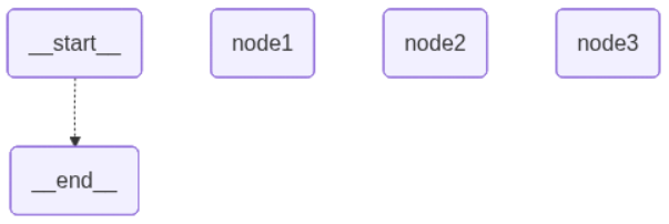

如果遇到条件走不同节点怎么办?
可以写动态路由:
  4. from langgraph.constants import END, START
  5. classInputState(TypedDict):
  6.     user_input:str
  7.     list_input: Annotated[list[int], add]# Annotated:为原始类型附加任意元数据,不改变类型本身的本质defnode1(state: InputState):return{"list_input":[123],"user_input":"This is node1"}defnode2(state: InputState):return{"user_input":"This is node2"}defnode3(state: InputState):return{"user_input":"This is node3"}defrouting_func(state: InputState):if state["user_input"]=='111':return"node1"elif state["user_input"]=='222':return"node2"elif state["user_input"]=='333':return"node3"else:return END
  8. graph =(StateGraph(InputState).add_node("node1", node1)# 添加节点1.add_node("node2", node2)# 添加节点2.add_node("node3", node3)# 添加节点3.add_conditional_edges(START,routing_func).compile()# 编译状态图)if __name__ =="__main__":
  9.     initial_state ={"user_input":"111","list_input":[1,2,]}
  10.     final_state = graph.invoke(initial_state)print(f"final_state的值:{final_state}")
  11.     graph_structure = graph.get_graph()
  12.     png_data = graph_structure.draw_mermaid_png()# 保存到本地文件withopen("langgraph_flow4.png","wb")as f:
  13.         f.write(png_data)
路线:
